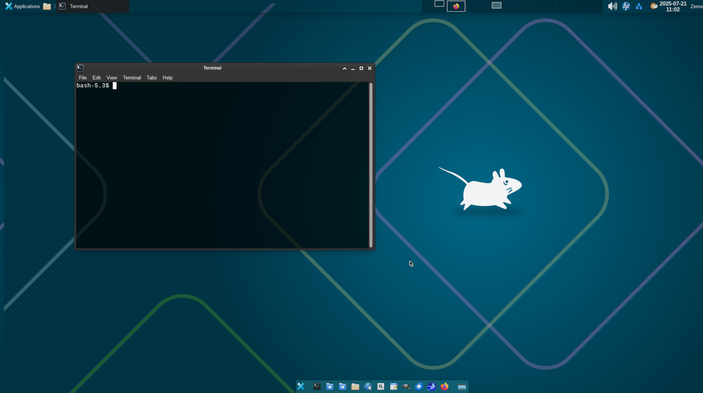

This is the most recent version of XFCE, out of the box it looks better than it used to, with dark themed panels and moderately dark default wallpaper. But it has the same problem that previous versions of XFCE have had in recent years in that if transparency is used it makes panel icons and other panel elements transparent too, and if more than a mild amount is used they will look all faded out. Right now I have a moderate amount of transparency in the panels, about 70% opacity, and it's very hard to read the clock. I used to be able to take it to 50% or less opacity without any problem. I'll see if I can find some way to keep the icons from becoming transparent along with everything else.
Re: Slackware-Current
I found something that helped a lot. In the panel settings under the Appearance tab, with 'Solid color' as the style, click on the color and add a custom color (the + button), then slide the opacity slider (hard to see the slider but it's right under the color range diagram) to the far left side until the resulting color is almost or fully transparent. Then after applying that setting, back in the previous window fine tune the opacity to the desired effect.

I've been having a weird issue with my auto-hiding bottom panel that has all my launchers - it only works properly for a brief while during a session, then it no longer unhides when the mouse cursor is moved down there...but if I move the mouse to the bottom of the other display it then unhides. I couldn't figure out why it started doing that, it's nothing to do with which display is primary. I didn't find anything on a search, though it's not an easy thing to find search results for. I finally resolved it by changing my bottom panel to be more like a traditional XFCE bottom panel - just wide enough to contain my launchers and expandable, and I set it to "intelligently" hide, so that it remains visible and only hides if a window moves into its space. I also minimized its height. So far so good, and with it shrunk down I don't mind it being on the desktop all the time so much.

I hate panel autohide malfunctions... I used to have KDE do that and have to delete my configs to get it back and start over.
I use "always" in XFCE for panel auto-hiding.
Do you have a saved session? I don't save sessions because bad parameters can get in there and cause tomfoolery like delays on logging in/out and panel position problems. That's ~/.cache/sessions for me, and probably still the same, unless $XDG_CACHE_HOME is set to something else. Try nuking ~/.cache/sessions
You can also play with the timings, if you create a ~/.config/gtk-3.0/gtk.css file with this:
Why I do it is that I don't like the panel hide delay, I want it to re-auto-hide sooner and 100 works well for me (note that there is still a bit of arbitrary delay, it will be a bit longer than 100 ms). Don't make that number 0 or the panel may not auto-show.
You can reload the panel with:
If you have a saved session, you might have to delete ~/.cache/sessions for it to work.
#XfcePanelWindow {
-XfcePanelWindow-popup-delay: 400;
-XfcePanelWindow-popdown-delay: 100;
xfce4-panel -r
Thanks Grogan I'll try that. I didn't think I had a saved session, when I launch XFCE nothing is left open from the prior session, but on looking in my .cache/sessions there are a lot of *.state files.
