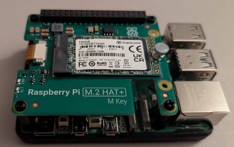

An NVME drive can be used on a Raspberry Pi by using an adapter:
Re: Raspberry Pi Radio
Holy snappin arseholes batman... that's bigger than the device
It looks like the heat sink and fan couldn't be used with one of those things mounted. It would be nice to have faster storage than that TF card though. Although, you'd be limited by bus speeds as to what you can do with it, it's not the fastest computer in the world anyway.

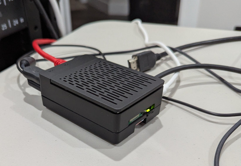

Finally got it in a case. I didn't want to go through the hassle of boxing it all back up and sending it back over a $15 case, I've already had enough hassles to deal with lately. It's just a cheap plastic one but it works.
Oh well, the one in the kit is a cheap metal one. The plastic is probably better

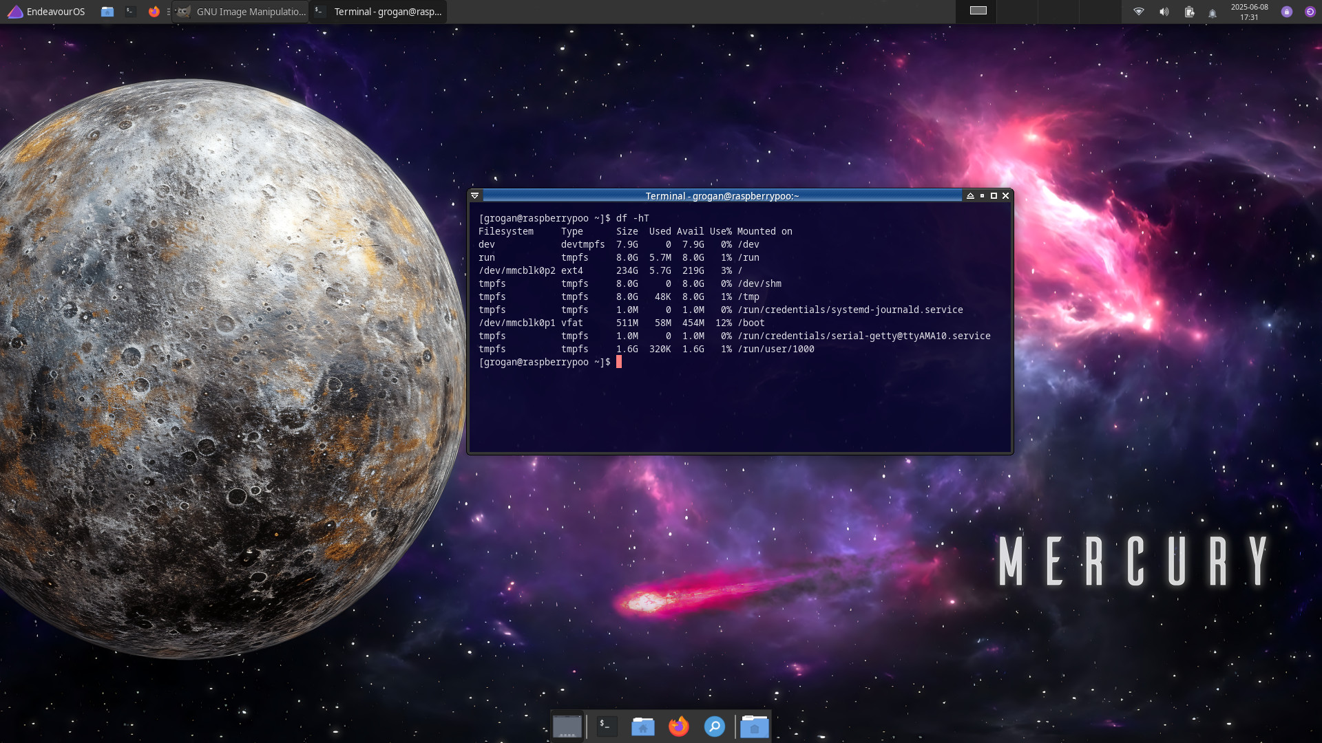

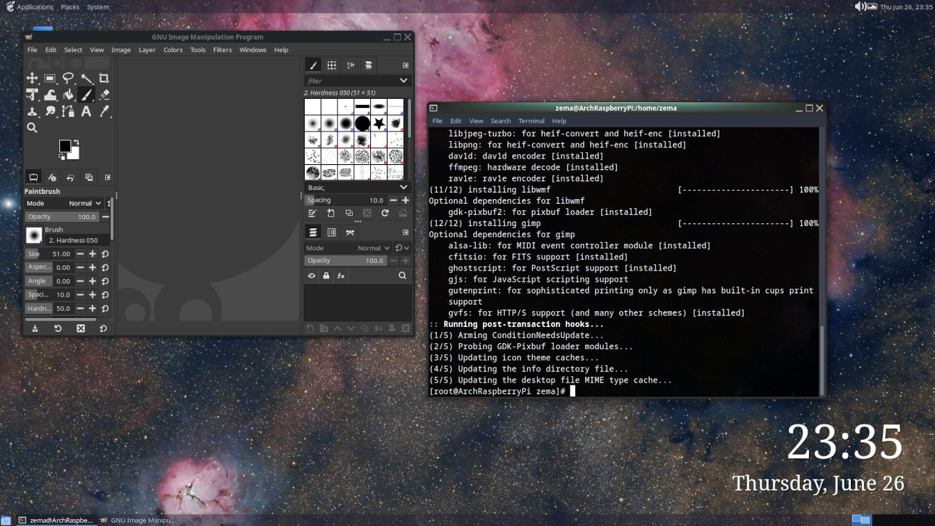

Here's what mine looks like now, I haven't done much with the panels yet, just made them transparent. The big clock on the desktop is a setting in Variety.
That looks great, I like the green gradient window decorations.
I haven't spent much time customizing it, the only thing I've done with XFCE is change some settings. It's a somewhat dark theme, good enough for an appliance that's meant to watch movies anyway. I'm still using the default "Mercury" wallpaper, I like it enough. I did sftp over my demonic "Rage" mouse cursor though. My style ("Plasmafire") will be broken on that newer XFCE, so meh.
Thanks, the Mercury wallpaper is in the mix too, I set Variety to use both local and remote sources (there are multiple sources that can be used including NASA images), with the checkbox checked to favor darker wallpapers. It changes them periodically, I think I set it to once every two hours.
