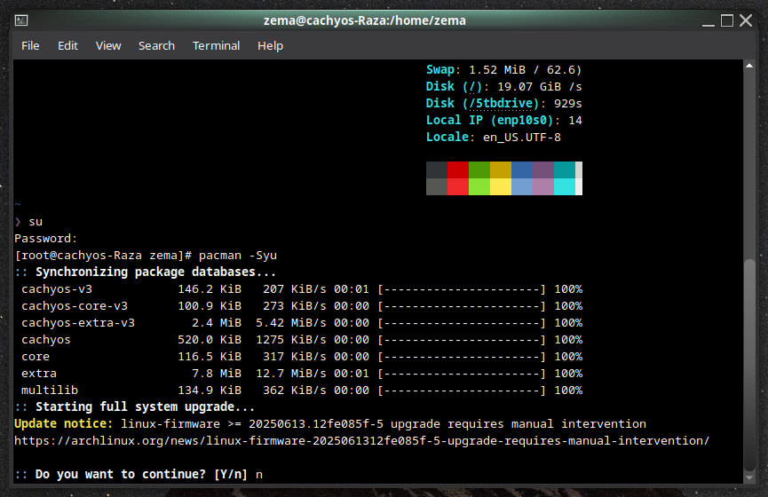

Had to do this on the Raspberry Pi 5 too. After the last update including Plasma 6.4 the HDMI bug reared it's head, I don't know why it didn't occur before under Plasma 6.3. On a Raspberry Pi there's no option of switching to a DP monitor, but a mini HDMI to DP adapter would probably be a solution.
I wanted to see if CatchyOS does anything different than Arch when it comes to this sort of thing so I ran pacman -Syu before fixing it. I like the inclusion of the notice from Arch. I normally check the Arch website first but I don't always remember.

All Arch based distros will be doing this. It's still going to wind up with most people having a shit tonne of firmware they don't need installed anyway, as they say, pacman has no way of knowing what firmware you're going to need. Even on ARM there's a bunch of unnecessary firmware for most devices. There are ARM SoCs that have Nvidia hardware, but not ours.

I had to use pacman -Rdd to remove linux-firmware because it's a dependency for the distro kernel package (linux-rpi-16k)
