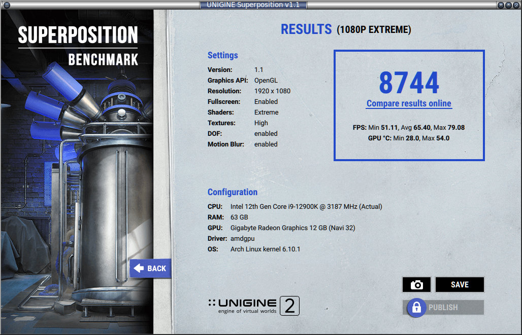

What benchmarking programs are best for really testing for stability?
Posts: 3211
Re: Intel 13th & 14th Gen Game Instability
I wasn't think of anything specific, more just something that's like a video game.
Here's a modern one
https://benchmark.unigine.com/superposition
Another
https://benchmark.unigine.com/valley
OpenGL/Vulkan
https://geeks3d.com/furmark/
Posts: 3211
I just tried that FurMark on Linux, as I'd not seen that one before. I'm getting about the same, around 200 FPS for both the OpenGL and Vulkan tests (full screen 1920x1080 with OSD HUDs showing). Slightly better with Vulkan

I'd say try that for opengl and vulkan but also try the Unigine tests (especially superposition), they are more like a video game than this.

I quite like the superposition one, with all of the interesting lab and test equipment imagery.
Posts: 3211
Yeah, it's a nice one and representative of the rendering in a lot of games. I only have an OpenGL rendering choice for those Unigine benchmarks on Linux, though.
